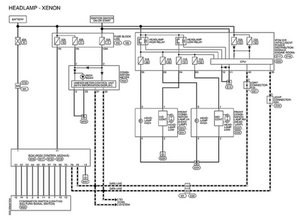

2012 Nissan Maxima- Passenger side headlamp only works on low beam. Bulb is fine. How do I determine what else it could be? Ballast? Relay? Fuse?
promo2110 your lights are fused separately and divided in left and right as well as further into high and low beam. For your Hi beam on the RH side check fuse number 49 which is a 10A fuse in the fuse box (Intelligent Power Distribution Module ;-) in the engine compartment. Sure it could be the control unit or the bulb but check one thing at a time. A simple check would be to flip the lights. If the current RH side works on the LH side and the RH side still does not work you know it’s somewhere in the IPDM CPU etc.
