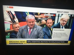

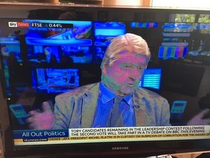

The problem with my TV was that the colours were bad, initially with areas having a sort of “metallised” look. That was how it started, back about April, something like this…
In the meantime things have changed a little. Now the screen is pretty dark when starting up, although the picture improves slightly when the TV has run for a while. While I could still just about watch the TV, I decided I would have to do something about it.
Looking on the Internet I found a few sites which seemed to show similar problems and they suggested the trouble was in the T-Con board. So that’s what made me hope that replacing it would cure the problem.
@espri that us a great way to start. Yes the polarized picture etc., could definitely be a TCon board issue. Let us know how it works out.
