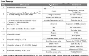

Hey guys! Before nothing, thanks for your help. Have a Samsung Galaxy S9+, these become my hands, and not power on, not charge and no display on screen.
When I plugged the cable into charger port the power consumption is 5 volts and 0,07 amps, but no charge. The battery should be in 3,85 volts but this have 1,54 volts, this point make me think the port charger is broken, but I will like first confirm this.

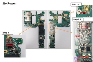

@stifgs start by following the No Power flowchart.

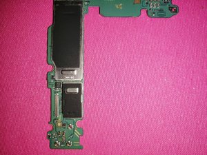

For this we would need some good pictures of your board to point out components etc.
This maybe a little easier just not as comprehensive
Bottom line is I’d start with a new battery (check your charger!). These guides will help you getting into your phone

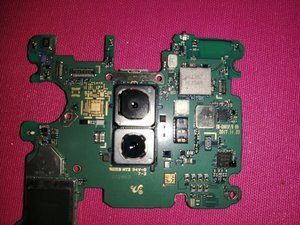

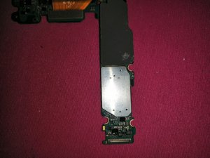

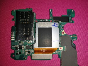

Hi @oldturkey03, add images from mainboard, with the new battery, the problem continue.
The button power have continuity in the chasis, but have to make test in the mainboard, but I have not much idea of how make.
