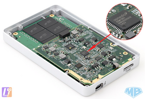

I have the storejet 500 SSD with 256gb, however, I’d like to put a larger ssd into it, probably a 1 or 2tb samsung evo. This is because it has a thunderbolt 1 port and most other enclosures have usb3 or tb3, neither of which suit my old iMac (21.5, mid 2011). I’d like to put my entire internal drive onto an external ssd and boot from it. Before opening the enclosure i’d like to know if it can be done or will opening it break it?

I don’t own a Storejet500 but did some searches and found this :
https://macbidouille.com/articles/test-d...
There is a standard 2.5’’ SATA SSD inside but the SSD casing has been removed. Not sure it will fit (guess not) with casing also.
The StoreJet300 has a 2.5’’ HDD (mounted in a rubber block) and a SATA SSD with casing will fit in there.
I guess Dan is referring to a Transcend JetDrive which I think uses Apple’s Custom SSD’s.
Good Luck

The case is designed to support the custom Apple SSD’s. It’s not designed to support the M.2 blade SSD’s. Finding Thunderbolt 1 or 2 cases is getting harder. Most are now Thunderbolt 3 which will not work with Thunderbolt 1 or 2 systems. But! You can get a USB-C adapter to USB-A connection case. Similar to what Samsung offers in their Samsung T5 SSD
Here’s a good reference on the custom Apple SSD’s The Ultimate Guide to Apple’s Proprietary SSDs
Excuse my ignorance but are you saying that my Transcend Storejet 500 ssd takes custom apple ssd’s? I figured I could just open the case, take out the 256gb ssd that is in it and replace it with a 1tb ssd. Also, I thought blade ssd’s were a different shape. If I get a samsung t5 I would need a usb 3.1 to thunderbolt 1 adapter, wouldn’t I? I just thought I could use the storejet because it has thunderbolt and that would be the fastest connection I could get on my 2011 imac, (without opening the imac up). The idea is to boot from external SSD.
These cases are designed for the custom Apple SSD's bundled with the SSD upgrades Transcend offers: SSD Upgrade Kits for Mac
These are the only SSD cases that support the internal custom Apple SSD's by Transcend. OWC offers a similar case option.
They do make a line of external drives which I believe is using their own SSD design. You would need to open it to see what they have done. They could have used a standards based M.2 or 2.5" SSD within it.
But, these cases are not able to support the custom Apple SSD which is what you stated you wanted to do "I’d like to put my entire internal drive onto an external ssd and boot from it."
