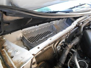

I live in northern NY where it is cold for a very long time. My 2016 Tacoma (maybe a year old at the time) began to not have a new car smell but rather a horrid undefinable smell. I couldn’t figure it out, so would turn my dashboard fan and heat on in an attempt to ‘blow the smell out’ of the truck. For days, I could not figure this out. It was not improving. I thought it was my shoes! It’s been a couple years, and so I can honestly say I don’t remember how I figured it out…… There was a dead mouse and it’s nest was on top of the air filter under/inside the glovebox. I have heard from other people/mechanics since that Toyota’s are known for this. Is there a way to figure out how they are getting in and block it? Thank you! Anne
@adktomboy I’d try some fine mesh around the fresh air intake (commonly found under the cowling where your wipers sit). Any opening the size of your thumb will allow mice to enter so it’ll be a bit of a chore.

not your exact model (its a ‘15) but same idea
For more on this check on here
Awesome! Wonder how I get that thing off that's lifted up in the photo...
It "pops off" but may need some persuasion with a prying tool like a big screwdriver. There are plastic pieces that may snap but can easily be replaced with some mounting hardware available at Autozone etc,. You could even try places like Autozone to remove it since I found the sales staff in general to be pretty helpful.
