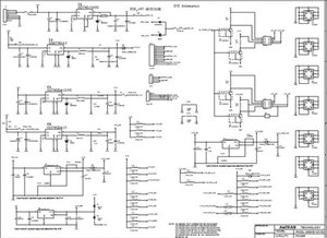

fastpacket 2000 take a look at this schematic. It is from a vizio p50 which apparently uses the same power board. Hope it helps if not we keep looking....
I hate to do this to you but this layout is different than the one currently on the set. The low voltage show LMs and Ns regulators which are not present on my P/S, sorry.
Okay thanks for letting me know will continue. I have another shot at it from a Hungarian site ;-)
