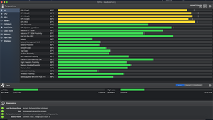

Let's see if we can get a better look at what's happening. Install this gem of an app CoconutBattery this will allow you to get a better view of the battery. In addition lets look at the thermal sensors and fans, install this great app TP Pro
Take snapshots of both apps main windows (you'll first need to adjust the TG Pro window so all of the sensors are visible with the fans). Post them here for us to see Adding images to an existing question

I can agree with this as i just swapped my battery with a MacBook Pro 15 mid-2014. Everything was fine before I swapped the battery and now after the replacement the processor heats up to 100 C when running a simple application. Word, Excel or Safari/chrome with 10 tabs. I have cleaned out the old thermal paste form the heat sink, processor and GPU. I have downgraded from Big Sur to Mojave and Catalina, to no avail.

Hi, here you go:

I've seen a fair amount thermal issues, rarely is the issue the battery based on what you described. Let's get something to figure out what's really the cause.
See screenshots above.
@rf202 - Your battery temps are normal! Batt 24℃, Batt Management & Batt Proximity both 30℃
So your issue is a process running hard. You'll need to look at what is running. I'm suspecting it maybe the M.2 SSD you installed. Have a feeling that's what is messing you up.
I can confirm that was the problem. After installing the default SSD, it would spike to 99C under load, but not as often. Any recommendations as to what 2TB SSD I could use that won't cause this issue? Thank you for your help!!
@rf202 - Other than another Apple SSD your only other option is a ground up designed SSD that matches Apples specs from OWC Aura Pro 6G
The problem you face is the limitations of this series interface. Review this great guide for more info The Ultimate Guide to Apple’s Proprietary SSDs
