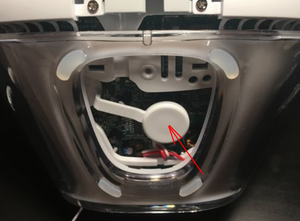

Does anyone knows which part is for the snooze? My snooze is no more working.
Underneath the white disk there is a microphone (a black round cylinder with a hole in it) that is activated when the alarm goes off.
The white disk transmits the noise (caused by the tapping on the housing) to the microphone which snoozes the alarm.
So it could be that either the microphone is defective or that is simply blocked by a speck of dust.
I just blew into into it and it worked again.
I do not know how easy it is to replace the microphone, as I have not yet take the lamp apart (it still has warranty)
Yes i also found this part and thought about this but i was not really sure about it but i think i will order an Replacment microphone and will play arround with it :)
Have you also tried how much the plastic parts need to be vibrating at yours?
Hi I think I found out the problem. There is a Piezo vibration sensor and it's oxidized. Have you seen at which position the sensor is at yours? I think there could be some with the sensor on the right side.
Info the sensor is 20mm diameter.
@timkrzyzanowski did you manage to change your Piezo sensor oxydated ?
I have the HF3520 and my issue come from this sensor as well. Did you find any spare parts ?
Hi yes somehow a resolder worked now for 3 years but somehow it was very sensitive. Last month the error occurred another time an this time in soldered an new Piezo 20mm element to the cables. But be carefull to solder with the lowest possible temperature. If you're in Germany I could send you one of those if not you can order them easily at aliexpress or ebay.
