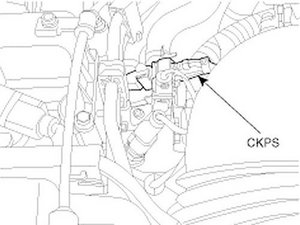

Where the crank shaft sensor at
Where the crank shaft sensor at on a 2009 Hyundai sonata GPS 4 cylinder.
marybostian4 on the 2.4L 4cyl engine the crankshaft position sensor (CKPS) is mounted on top of the bell housing right where the bellhousing meets the engine block.
Hard to describe but top left of oem airbox filter you should see the cable
