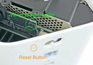

OK you’ll need to pop the bottom cover to gain assess to the reset button header to disconnect the reset button cable.
Then see if that fixes it.
@danj Okay, popped the hood. Tried powering on without the switch, same thing. Not showing in AirPort Utility. Reconnected the switch and held down the actual switchboard instead of the outer plastic button top, nothing.
Like before, I see a brief moment of hope, where my adapter lights start glowing and then go dark. Any other suggestions? Or is it time to scrap this one and move on to newer routers?
