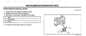

2004 Mazda 3 horn
2004 mazda 3 horn not working

Tracy, first check that all the wires are connected to your horn. Use a multimeter and have someone push the horn button to see if you have power going to the horn. If you do, then it is the horn itself. If not, then check the fuse and/or the horn relay.
