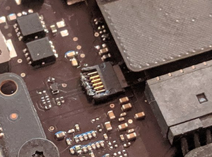

Well you’re fan connector was damaged by the previous owner or the person who last serviced the system. Your logic board will need repair someone with the proper skills should be able to replace it. Here’s an image on what the connector should look like

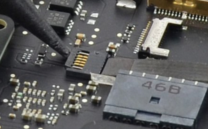

Vs your connector
The clamp latch is missing and it appears someone tried glueing it down which is not the correct fix.

The design is a clamp which applied presser onto the ribbon cable pressing it down onto the contacts. I don't see the left side so its likely only part of the connector is clamping.
This makes complete sense given that the fan still works, but no data is transmitted to the operating system.

Just had a MBPR 13” 2015 come in for repair with the same issue. After trying a replacement fan with no success I looked under the clamp latch and noticed a small amount of corrosion. After cleaning that off I reinserted the ribbon cable from the fan and noticed the clamp latch was not completely inserted on the connector properly. After closing the latch on the ribbon cable I put a small amount of pressure on the latch to push it into the connector all the way and when I turned the computer back on I was now getting an rpm reading and the Apple Hardware Test was no longer giving an error code.
Hope this helps!
