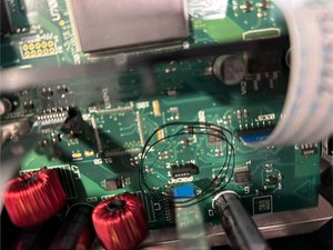

for some reason you have this wire disconnected.
Remove 6 screws from the bottom, take off top panel and connect the wire again. Picture included.
