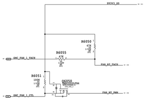

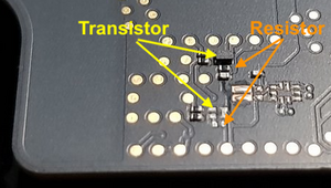

Update: Soo I have obtained the schematics and the circuit which controls the fan speed has transistors Q6000 and Q6050. Upon rechecking my board, get this.
Looking a bit closer, there should be two small black boxes, one on top and the other on the bottom.
It seems that upon reassembly, these components were scraped from their pads. Problem is, I can't find them. Pretty hard to buy one either.
Looks like you are missing:
- Q6050, Diodes Inc. DMN32D2LFB4R6051
https://octopart.com/search?q=DMN32D2LFB...
- R6051, 100k 5% 1/20W 0201 resistor
https://octopart.com/search?q=100k+1%2F2...
Not sure about the components to the right of this, which are related to backlight current sensing.

The error is a logic board error. You’ll need to trace out the logic to find the defect.
Sadly, Apple has done a good job controlling their schematics and board view drawings. The only thing out their is an incomplete schematic & drawing which is missing the fan control logic.

@mrman - Yes, your logic board is missing some components! Looks like they got snagged.
These are the fans tach control logic.
If you can’t find them at one of the part houses or a junker board to steal them then you’ll need to replace the logic board.

I was able to buy the missing parts but it is extremely tricky to solder them. So, as a last resort attempt, I decided to short the fan PWM pads instead and now the fans are now in sync! Thank you, Dan!

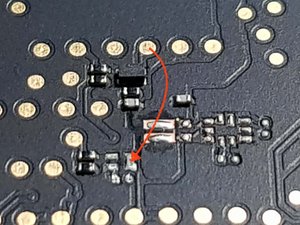

I basically soldered these two pads using magnet wire so that the other fan would spin. It's important to use magnet wire (enamel wire is the same thing) as the wires I use for breadboards never solder properly on the tiny pads.
Just don't heat the pad too much because I did and the gold circle pad came off. Luckily I was able to scratch the trace so it had something to stick to.
Below is the schematic of the fan circuit and the FAN_RT_PWM would just connect to the FAN_LT_PWM from the other side.
