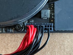

Daniel,
I just opened up my 2018 Mini and measured the voltage (not plural) coming from the power supply connector as well as a continuity measurement of the logic board connector.MacMini2018_DC_Connector.pdf
As with the 2012 & 2014 models, the logic board needs ~12VDC. That’s it. The people claiming the 2018 power supply is outputting multiple voltages have clearly never opened one up and measured it. There is no basis to support this information as I have just confirmed for myself. As for the claims that these machines run on a “strict voltage tolerance”, I’m not buying that either. I ran my last Mini (i5 2014) on 13.6VDC because the point was to power it with a LiFEPO4 backup battery.
However (as noted in the drawing) the logic board connector shorts the pin marked with an asterisk (*) to 0V or GND. This is a little suspicious considering this connection is not made on the 20pin cable that connects the PSU to it. All other connections are mirrored. This could be Apple’s way of trying to foul up the not-so-savvy DIY enthusiast trying to convert his/her 2018 Mini to run on straight DC power. Meaning… it could be designed to where the power supply has to see that connection or else it’ll shut the computer down. Doubtful since I was able to measure voltage potential with the 20pin cable not connected. Probably more like ground loop prevention in some other part of the machine.
As for why they chose to use a 20pin connector to carry a single voltage… in a word - amperage. The previous models had a 85W PSU. 85W / 12V = 7A This one is 150W. So, 150W / 12V = 12.5A. They chose to use multiple runs of thinner wire instead of two big fat wires which is perfectly acceptable. Also because if one of the smaller wires break, it will probably still work. If too many break, it will have issues starting up. The only reason it needs such a big supply is for when it is starting up. It has large voltage spikes during that process. I measured them as high as 11A. It seems to idle around 2A. Any decent size Lead Acid or Lithium battery you use will simply laugh at that.
Keep in mind while looking at the diagram that it is drawn from the POV of looking at the CONNECTION SIDE of both the male and female counterparts. In other words, they are a mirror image of one another. I made sure to include the key on the end of the connector for reference. Hopefully this all makes sense.

Aaron - You have a few errors in your drawing!
As to multiple voltages there are multiple 12volt services running in parallel gaging them together is not what you want here.
I’m not sure I understand your reply but… If you run a continuity test on both the logic board and power supply output (not while powered, of course) you will find that my drawing is indeed correct. As stated in my post, there are multiple conductors carrying 12V. There are also multiple conductors carrying 0V. Your reply would lead me to believe that you are under the impression they are coming from separate regulators but this is not the case. Spreading the voltage out over 7 conductors is just a way of supplying enough current to the logic board safely.
Have you opened up your machine and performed these test? If you are comfortable with it, I strongly urge you to do so and you will see for yourself.

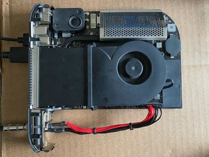

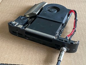

Here is my progress so far on the mod using the pinout described by Aaron Thompson. I designed and 3D printed a little bracket that holds the Anderson connector in place. I was originally going to JB weld this in place, but I plan on redesigning the bracket so that it screws into the same holes that the original PSU was attached to on the frame. Or not. I don’t know. :-P
Looks great. I like the Power Pole connectors.
I did the wiring exactly to the diagram. I get fan spin and a boot screen but then just after the apple logo pops up the machine turns off. I got it to the login screen once but then powered off.
What type of power supply are you using? Did you keep in mind the peak power draw during the boot up phase?
@curta I just re-read your previous comment and realized that you’re using the same power supply as Aaron. If his is working and yours isn’t, I would suggest double checking your connections. Also make sure you didn’t insert the pins into the housing mirrored. That could be bad.
I had to use the first two (8A) taps on the PSC in parallel. Sorry I didn’t mention that earlier.

I had a 12V 10A power supply but that’s not enough to get past boot. I had a battery and it supported boot. Got it working and seems to function as normal while on battery. I tried it with a cigarette lighter socket in a car and it didn’t get past boot, not sure why. I used a high amperage locking barrel connector from switchcraft that fits in the chassis without having to modify it.
Curtis,
Once again I apologize for not responding sooner. I don’t get over here much. You’ve obviously figured out by now that you need a PS capable of enough current draw to get over that initial hump at startup. The stock PS is 150W. 150W / 12V = 12.5A. The cigarette lighter in your car probably is current limited so you don’t damage your battery and need a jump start every morning, It possible that car batteries aren’t capable of firing like a lithium. Lithiums have that discharge curve that looks like a hockey stick. They work for what seems like ever and then all of a sudden, they’re just dead.
