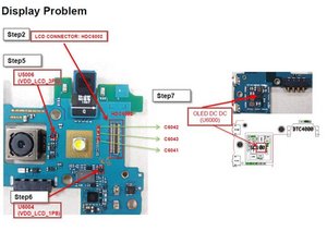

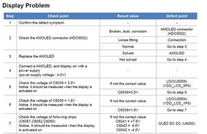

The very first thing you should fix is your derogatory user name. After that you need to remember that this is still a water damaged phone so it will act different. you would have to disassemble it and check the motherboard for corroded components like filters etc. Best case scenario it is your display that is failing and worst that it is your motherboard. Check for damage around U6000
