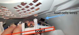

Facing the 0000/max scale issue, after some reading I decided to look into our TM5. I found somehow strange that some people fixed it “cleaning contacts” or just “disassembbling and re-assembling”. I’ve worked before with load cells, and they are “solid” devices, with soldered and glued connections in the cell end (no contacts to clean there).
So I looked at the mainboard end of the load cells wires, at the right back side of the board. While checking the connectors, I noticed that the wires from the three load cells (three groups of four wires each) run quite near the board components, even touching the board, and had ferrite beads around them to reduce electronic noise.
Load cells produce quite small voltage signals, so they are very sensitive to noise from board components. So I just pushed wires and beads some milimeters away from the board, checking they kept there after reassembling.
Now the scale works fine (I’m too lazy for further testing, maybe connecting an oscilloscope probe to load cells output while moving cables would confirm or discard this theory).
Hope this helps.

Ángel gave me the track with his technical description to isolate the problem.
I didn't want to disassembly the machine, so I thought that maybe if I could move the wires shaking the machine, it would work.
I tried shaking it upside down, didn't work. I tried shaking it in lateral movements, didn't work.
Then I shake the machine vertically, in its normal position from up to down, and I hit softly the base of the machine against my knee at the end of the movement from up to down while I was sat (not hitting the rubber feet, just in the space among them).
It worked!, the scales began to measure with 0,00 g. of error.
It clearly seems that the TM5 has a design problem, and the wires goes too close to some components that produce electric noise, altering the measuring signal.
Vorwerk should fix this design problem transparently instead of request the customers to send the machine to the technical service and return it without an explanation of the fail.
Many thanks Ángel!

I finally solved the problem opening the machine front panel and sticking the wires to the plastic of the case (behind of the electrical board).
Here you have a picture of the wires after I put some black adhesive band in order to stick them to the Thermomix case.
