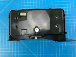

I am trying to access the ice dispenser on a ge profile door. It has no trim around it on the outside of the unit and I can’t seem to figure out how to access it to replace it
Update (06/07/2019)
My model number is PFSF6PKWBBB. I have seen an access hole up under the control panel is my only guess. I have tried with a small screwdriver in that hole but can’t find anything up in there that releases it
Thanks for your help and the link! You showed me the missing piece to the puzzle. Have a great day!
@jerryval, see my update above.
Thanks for the help. You made my day…..been trying over a month to figure it out.
@jerryval You accidentally chose your comment as the solution.
You typically access the ice door from underneath the control panel. See https://www.youtube.com/watch?v=dvbXkCcl... starting at 50 seconds.
If you provide your model number, I might be able to provide more specifics.
UPDATE
Given your model number, your panel cover is held in by tabs:
To release, you have to insert a small screwdriver in the hole you found and push out on the tab holding the bottom corner of the panel. See the following video, https://www.youtube.com/watch?v=6bTbK9Zt..., starting at 1:24 for a demonstration.
