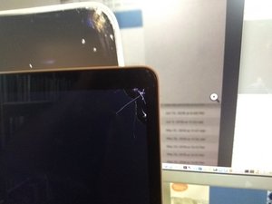

I broke the retina screen on my air, and I’m curious to know if it’s replaceable and how difficult it would be.
In my case, three small particles resting on the shelf below the keyboard penetrated my screen when I carelessly snapped it shut the very same day I purchased my MBA. I've been using it with an external display ever since. I'm now considering buying a replacement screen on Alibaba, price $205. That's a whole lot less than Apple (about two-thirds). I hope the repair is self-doable! Time to read on ....

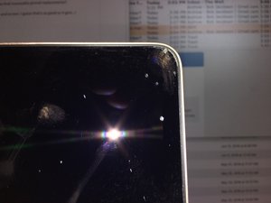

@bobjacobson - How about posting an image of the damage, There might be a solution in your case if I understand where the damage is Adding images to an existing answer
@danj Okay, Dan, I'll do it in Add your answer.

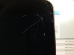

I did take photos, but they're indistinct (see above). The top one shows the flash of my camera brightly; the actual contact marks that some object left and the bruised corner of the bezel are slightly visible. Pretty much the same for the second photo, which is a little out of focus. Apparently,, any damage to the bezel renders the entire screen inoperable. At least it is on my MBA. Thanks for your thoughts.
I uploaded one more photo, the top one of the three. You can see the few functioning pixels lighting up in the upper right corner of the screen. I have no idea how this damage occurred, as there were no items or objects on the keyboard to create this damage just from closing the lid. The rest of the screen is black, although it glows very dimly when I turn on the Mac, then it goes black except for these pixels. Or so it seems.
@bobjacobson That seems to me a retina panel..which part of it do you refer to with bezel ?
