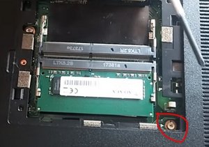

i have an Asus vivobook X542UN
i took it to a repair shop to upgrade my ssd (so this happened after it was opened) and now the laptol only runs on the charger and turns off immediately if i unplug it
the battery is almost new and it ran like a charme before it was opened
the repair shop wouldn't take responsibility for what happened so im trying to fix this myself now, what might be the problem and how do i fix it ?

It turned out that they simply fried the battery somehow, most likely a short circuit.
Only possible solution is to replace the battery

There is a two white metal screws near under the RAM cover, One of them makes contact on two tracks of main board and it is must be there to run on battery!

Thank you veryyyyy much, that is exactly my problem from 3 years ago, when I gave my device to a repair shop to add a SSD, they broke one of these screws and used glue instead (!!!). therefore, its connection to the aluminum of the keyboard was disconnected, and I find it today :(
