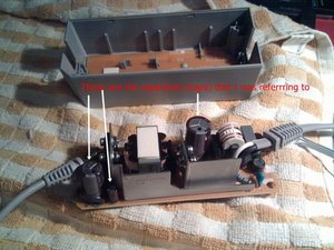

Possibly a failed capacitors, that is now leaking its content, as it is slowly melting away and getting ready to cause a fire inside your dwelling. So, best advice again is to not use it. Here is more of an idea what is leaking....Good Luck and STAY SAFE

Inside of your adapter , among many other pieces and parts, can be found numerous types of capacitors. Some of these are made using a liquid electrolytic substance. To give a general idea: think of the manner as is used in common 12v (car) batteries. These devices can fail at any time although it is more likely for some to fail sooner/&/or less predictably than others.
