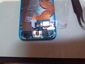

In order to operate my home button, I need to push extremely hard. What could be causing this?
Do I need a new button? Is there a problem with a flex cable? Is there some other easy fix that can be done by making sure that all the parts are in place?

I had a similar problem with iphone 5 that occurred after replacing the digitizer assembly. Turns out that the home button cables end with two metallic circles, pointing towards the inside of the phone, was slightly out of place. I repositioned it to match the two golden color wire hooks on the back assembly. The metal circles are supposed to touch the two wire hooks. I pulled the two wire hooks outwards - so that when they flex back, they are slightly higher than the past position. Relaced the front assembly and that solved the problem.

I have come across this exact issues a few times. The home button itself is just a piece of plastic that pushes the flex ribbon beneath it—which causes the circuit to short, making the home button work. I can pretty much guarantee you the flex ribbon is the cause of this issue (erosion/poor quality part/rust etc.) and can be fixed quite easily, however it does require a complete strip of the ipPhone and requires the screen to be taken off. This guide should help you get to where you need to go in the device.

I have fixed several iphones and this is one of the issues I encountered, I tried a new home flex and it did not work. I knew the home button flex had to make metal contact with something so I lifted the two prongs on the bottom that when the screen is placed down it would make contact. That seemed to fix the home button on two phones. It's worth a try before you purchase a new home flex.
