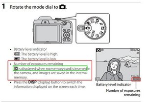

Also check that the SD card is being detected by the camera when it has been inserted
Here’s how to check. If IN is displayed the card hasn’t been detected
