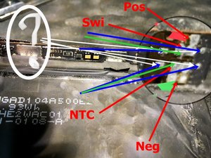

Battery side pinout or schematic pleease...
So the flex cable that the battery uses to plug into the ipad ripped off of the battery side. The part that plugs into the 4 slotted plug is good but cant figure out what solder points on the protection board on the battery are the temp and other signal wire. I have figured out which ones are the +\- but have yet to find any publications regarding the battery protection circuitry layout/ schematic or anything about the physical battery and not the ipad circuitry which is easily found. In the schematic for the entire ipad itself has the battery connector side information on the ipad side but says nothing about thr actual battery itself.. . Please help!! :)

post another image but this time include all the printing that is currently only partially visible (L hand side of your image)
I dont want to put you through the googling on all that.. those sets of hieroglyphs came up with nill and i tried searching all different kinds of ways. The closest ive came was searching up the model numbers on the other side. I thought that those only cooresponded with the device associated with the battery but as it seems each device no matter what antenna, memory, colors, or specific model the factory device is, the batteries are all made specific to that device. So if you pull the plastic condom off of the freshy apple box first meaning packaged by apple, no refurb, than the battery will be specific to your device minus sereal and coded info..
Any who the viable information on the battery is 3.72 V 4440mAh 16.93 Wh A1445 616-0633.
best i can do with pics for now until i dig back into it and take back off the lcd, digitiser and the million little godforsaken satan screws from the metal plate to get back to the battery.. i saw one for 25$ but im in this with both nuts now and either will go up in flames or with a hammer.. (the battery..). Then i buy 2 new ones just so i can take it apart and update then smash it with a hammer also.. thanks crapple..
@itrynafixit what I get is from top to bottom:
Pos
Swi (single wire interface=stores the battery code and tracks battery readings, including temperature, voltage, current and SoC )
NTC ( NTC thermistor to “control” temperature but this is another story ;)
Neg
Check with a multimeter if you have continuity between the points marked by a blue arrow and the pads marked green. If so they could be testpoints. If not then check to see if you have continuity between those and neg. That would make them potentially ground connectors. We may find proper schematics if we can identify the battery by anything else but the Apple numbers.
The outer 2 blue arrows have no continuity with any of the points close by but i did see that before the cable entirely came off their was a pin leading in between the two biger +\- squares so assuming the other point above is the other pin i need to connect to..
However my valiant atempt at this i actually have those two swi and thq reversrd.. so will try flopping and update on if it actually accepts and restores then from itunes instead of getting an error 21 i think it was..
