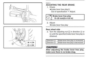

I want to tighten my back break. I think i saw the right video of how to do it but the bolt might be too old and cant turn.. its a 2006 yamaha vino with 6,489 miles.
Brady Reitzel  here is how to adjust the brake
use a proper box wrench to loosen the nut. Spray some lubricating oil on the threads first and let it sit. If you cannot remove it you will most likely replace the brake cable and need a nut splitter or similar tool to get rid of that nut.
Here is all about the rear brakes Vino-125-rear-brake.pdf
