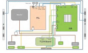

My tv screen shows vertical lines sometimes and even turning off and on again doesn't fix it. It does not depend on the video source, as it also exist on the tv menus. So it has to be a hardware failure, but I want to learn what can cause this and how to debug it. The lines move (when the image moves) and their colors correspond to the actual colors of the image that should which should be visible.

@onycro it is possible that it is the T-con board but the lines are bigger than I see on failed t-con board. It could also be a main board error or panel failure. I’d be prepared to replace the main board as well.
BTW, Philips love to use chassis number instead of model numbers. Your TV is a QFU2.1E LA chassis

Sorry to hear that but I figured it wasn't that due to the line size etc. Most commonly would have been a failed main board or a bad panel.

@penyo If it's not uniform and seems to change with conditions, unfortunately the panel is probably damaged internally. It seems to happen relatively frequently on modern display panels.
I guess rather than wasting more time on searching an LED screen and main board, I should just call it quits and move on to a new TV...
