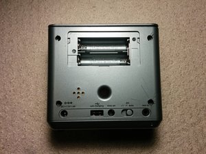

iHome iBT232 Teardown Guide
— Step 1 : Find the hidden screw holes —

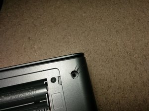

I will spare you agony. This device has four screw holes. You need to open them first before opening anything else. Where are these said screws? Your first guess might be at the bottom, under the black rubber shoes. But alas, no they are not here.
Look closer at the back - the panel with all the ports (USB, power, battery etc). Don’t see anything? Look closer… Still don’t see anything? Well I can assure you the four screws are here. Look for four circles. You see, iHome decided to go all out in hiding the screw holes. Instead of the traditional stickers, the screw holes are blocked with plastic cylinders (that are the same color as the panel).
How to remove this plastic plugs? What worked for me was stabbing - I mean piercing - a hole into the center of these plugs using a tiny screwdriver. I then proceeded to enlarge the hole until the plug disintegrated. Thankfully, the plugs are made of a softer plastic making this possible.
