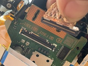

@hellomacos hey. So I’ve gotten the casing apart and the wires separated. Pretty interesting
These are the important notes so far
The connector to the motherboard I did t expose all the way but from the “tear down” guide. It seems to come apart one more time? Not sure, it’s a small connector that plugs in up and down not in and out
. After further investigation. I see that it does not. Also I discovered that some of the metal I thought was insulation. Was actually a wire. That’s good news lol.
21-22 wires
I may need to micro solder the wires back together and re insulate wrap and shrink cover it I don’t see myself throwing any caps on these small wires.
Any suggestions?

Here is a better photo I actually took it apart more slowly this time. 2 sets of 2 wires are wrapped separately. 1 bundle of wires is wrapped separately. And the more metallic looking wires are exposed.

You could repair everything by soldering it back together but I wouldn’t recommend it unless you have some experience first
This will be quite time consuming so if you want you could buy a faulty VR and use it as a donor so you can get the cable that you need

Ok, so I got the VR headset fully functional again! what an endeavour! the wires are very fine and very easy to break. I'm gonna start working on a write up with pictures
