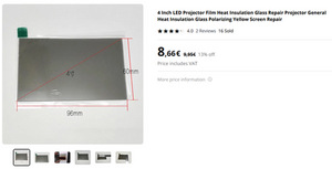

Ok So there is a SOLUTION. If you want to fix your little projector you need to order the part below or one of the same dimensions. This part is a little bit thicker than the stock one but if you carefully press it in or widen the side guides a little bit it will fit and work perfectly. I ordered two so I would have a back up. It did take over a month for the part to come. I wrote it off because they never sent an email to say it had shipped, but eventually it did show up. That's ordering Chinese parts for you. Good Luck! Haribol

I just placed an order for that part! My projector also has the same brown smudge, so hopefully this fixes it! Same dimensions, so crossing fingers!
I think the most important thing with these little units and the issue with the polarized lens burning is you have to keep them from over heating.
Don’t leave them on when you’re not using. And keep them ventilated with fresh air, a fan, or in air condition.
That said I have not had to replace the glass again since first doing it with the part from aliexpress.com so it may have been a manufacture error in the original glass and unit as well.

I believe I have the same problem as you. DbPower sent me a replacement unit which is now displaying the same symptoms after several months of use. The noise is the fan squealing due to lack of lubrication at the bearings. The brown smudge is a result of improper cooling and overheating of the LED light circuit as a result of the defective fan (my second unit did the same thing because cooling is insufficient overall). Without taking it apart, I can only assume that it is the LED itself or a plastic lens or filter within the lighting circuit.

It’s likely just exasperating it. If you’re handy it takes only about 15 minutes to get down to the polarization filter and you’ll be able to see if the film is burnt or not.
@Max Nuccio Thanks Max! Ordered the part (actually followed suit and ordered 2) and managed to put the thing back together successfully (and it still turns on!). Thanks for the aliexpress link and advice. Feeling accomplished even though it didn't require anything but a screwdriver...
You are correct. I diagnosed the same thing after disassembling. I found a thin glass filter with polarizing film on it which had burned from the fan sticking. The fan may have stuck from dust, lack of lube, or running the unit too long. After searching for ages for the lens which would seem like an easy and cheap replacement (the unit does not work properly without it) I found a couple from China but the cost plus a fan was about the same as a new unit some of which have upgraded fans.

Ok fellow brown smudge DbPower T20 users! I may have found a fix. You may want to wait till I get and install the polarizer filter before you order, but…….. they ARE available on aliexpress. See link below. I ordered two for like $15 with shipping, just because it will probably happen again. The projector is poorly designed and doesn’t stay cool enough which heats up the polarizer film on the thin glass and burns it.
It’s pretty easy to get to the part in the projector just follow the tear down guide on ifixit.com and pull the middle glass filter that looks like the item below. Reinstall the new part the same way as the old and reassemble. I’ll do an update when I get and install the part. My guess is it will take a while because it’s coming from some far off destination.
