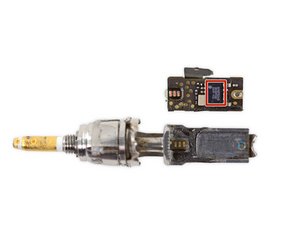

My kid dropped my iPad pencil and the golden piece broke off can that be repaired and where do I find the the replacement part. What is that called?
I think it’s called transducer and from what I’ve read so far it’s not repairable.
The inner tip contained precision circuitry and is screwed in from the inside then glued and welded shut, this thing is not repairable.
If I remember correctly, there should be a spare tip when you purchase the Apple pencil
Unless it’s the nib that broke off, which i don’t think can be repaired/replaced
I do have a spare tip but it's the gold point that broke I didn't receive a spare tip for that
