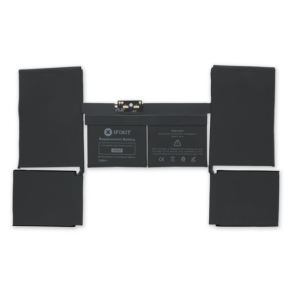

I don't know how I found out but I discovered that early MacBooks such as this one (which was the second edition) suffered from a "bulging battery problem" that Apple considers a safety issue. From a practical standpoint, when the battery bulges, it presses against the bottom of the trackpad and causes problems that can be a button that is difficult to press, an unresponsive trackpad, or as was my case, an over-sensitive trackpad. All you have to do is sight across the bottom of the laptop. If the battery is protruding, Apple may replace it for free (or, at least its worth asking them before trying something more expensive). Anyway, they replaced mine for free. Hope this helps should anyone have a similar problem in the future.
My wife's Macbook Air was suffering from the overly sensitive trackpad issue. At first the trick of pressing hard on the diagonally opposing corners fixed the issue but eventually it persisted. I sighted along the base of the computer and didn't notice any bulging but decided to try the battery replacement none the less. So far so good. It's only been a couple of days but the issue had previously been a steady annoyance. Really appreciate this site and its forum!
