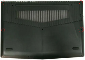

Hey People,
before i ask my question to help with, i’d like to introduce the keyboard problem / issue of this notebook:
People buying this notebook are first amazed of the price-performance ratio…but then…oh no, some keys of the keyboard won’t work (like E, G, H, Fn, NUM8, NUM/…). There are several solution suggestions on the world wide web, which MIGHT solve the keyboard problem, but none of these solution solved my defect keyboard - so these “solutions” are no real solution, they don’t fix the problem, they’re just like crutches helping the ill, but not really healing the broken leg e.g. (i hope you understand this example :D).
Here is a list of the suggested solutions found on the internet:
1.) (my favorite one xDxDxD)
Origin of the problem (ootp):
Maybe mechanical strain on the keyboard or mainboard?! The WWW doesn’t know ¯\_(ツ)_/¯
Solution:
Remove the middle outside screws of at the back of the notebook, if this doesn’t help, try to remove all three middle screws - then your keyboard will work again - MAGIC (sry, this didn’t help mine, but still helped other notebooks, why, i explain downwards).

Did i forget any WWW solution?
None of these solutions i found helped me. Here comes my suggestion (NOT SOLUTION YET) of a possible origin of the keyboard issue:
When starting up the laptop, i figured out that the keyboard starts working after a while - sometimes after 15 min, 30 min or an hour. After startup i tried to put mechanic preassure onto my upper case or keyboard, because i supposed a loose connection inside the keyboard madrix or mainboard (compared to the WWW solutions above). I seemed to help, but a few days later, i didn’t help anymore.
Then i figured out, that even without pressing on my notebook, the keyboard started working well after a while. If i left my laptop for 15 - 30 minutes, the keyboard won’t work again…then after working with the laptop again for a few minutes, the keyboard starts working well again….soooo, what is this? What could happen to my laptop, when leaving it?
COOLING DOWN!
When not working with your laptop (and windows is not doing any update what ever background cpu stressing stuff) your cpu will work less or maybe go into power saving mode. This will make your laptop cooling down in temperature.
This might explain, why the keyboard (when starting it up at room temperature at the morning) starts working after 15-30 minutes - but when leaving it, the laptop will not cool down to room temperature, so the keyboard will start working again FASTER (only 2-5 minutes).
So it MIGHT be a temperature problem?! We don’t know yet.
I tried out the following:
After startup, to increase the cases and laptops temperature faster, i moved my hand fast over the cover to produce frictional heat. This seemed to help a bit, but after a week my case and keys would look very bad xD.
Next step: HEAT GUN
After startup i tried to NOT doing any hard mechanical pressure on my case nor keyboard. Then i SOFTLEY (please do not melt or damage your laptop with a heat gun) warmed up my case and keyboard. After a few minutes (and not 15 - 30 min) my keyboard started working - an evidence of a heat problem?!
Step three: stressing CPU & GPU to produce heat
after i tried out the heat gun, i kind of prooved a heat problem. So i searched for an easy way to warm up the laptop not from outside, but from the inside out - and what are the most heating modules? RIGHT: the CPU and GPU.
I downloaded the two famous programms “Prime95” (stressing the CPU) and “FurMark” (stressing the GPU) and for monitoring of the temperatures “MSI Afterburner”. After starting up the system cold the next moring, again i tried NOT to stress the laptop machanically to exclude mechanical origins of the problem. Then i started the two programms and stressed the CPU and GPU for a while. I kept trying to press the non-functioning keys softly - after a few minutes, the keyboard starts working …. TADAAA another evidence of a head problem? :-)

hello there, I’d like to say that after I had the laptop for 4 months this problem appeared and them i sent it to the fixing center and after 3 months of that same problem re-appeared and this is really frustrating as I lost my work in the first attempt to fix it because the fixing center deployed a new OP (to check the keyboard)! This is definitely a problem based in this line of production of the Lenovo y520
some keys didnt work when the bottom cover shut, i try many times but same issues. in the end i put out the RAM cover, the keyboard was flawless
lemme try this.
In my case, it was that I had put the shield in crooked. Causing the keyboard to do weird things when I put the back cover on. If I didn't, the keyboard worked flawlessly.
The fix for this was to remove the cover, reinstall it properly and close the case again.
This same issue. I found a solution that helps for me. Squeezing bottom left corner of case, something like 2-3 cm under the Fn button. It helps me every time, for now...
This. Your advice helped me instantly. I don't think the problem is solved permanently this way, but at least I know what might help if it reoccures.

Hi, @dreckssau. I have the same laptop and problems you described. I managed to solved it around 2 years ago by removing the three middle screws on the back but the e, g, h, fn, 8, 9 issue has reappeared after all this time. The GPU stress test doesn’t work in my case (although it worked once). Is almost winter here so my laptop is cold which means your theory could work just fine. Have you managed to solve this or discovered anything new? Thank you in advance.
I have the same issue. Well… lucky for me. I purchased new palmrest with keyboard in amazon. at first it works fine. but after few months the issue re-occurred. so now i’m going to try to remove the ram cover. will get back to you guys once tested.
Update:
I just got the ram cover removed. It appears to be working fine. Wish me luck. Well if ever it happens again. I’ll be sure to update you guys here.
now the keys are working but it is now doubling the characters. LOL
I removed all back cover screws and removed the metal ram cover. I placed thick wads/rolls of tape behind the letter “E” and turned the unit back over with the cover snapped on only. I pressed hard on the E, G, and H. The keys worked. I also put clear plastic tape over the ram cards to prevent electrical shorts. Sometimes while pressing hard on inoperable keys the whole computer would turn off and Id have to disconnect the battery and reconnect it then it would turn back on. It once went into a disk scan with fragment recovery and I had to boot in safemode to get it to work again. It seems the problem is a multi faceted wear and tear problem with the keyboard. Poor design over time results in a disconnect of the E, G, H, and Fn keys. I originally thought that my daughter spilling liquid on the keyboard was the problem but after complete bottom case replacment the problem was fixed for awhile but returned. Then I found flexing the laptop in certain ways caused the keys to reactivate. I have found the proper bracing and stress to place on the backside of the keyboard to get it to work reliably.

I upgraded the RAM in my brother's keyboard and had a similar issue. If you leave the bottom case off, what happens? If it works with leaving the bottom case off, I might suggest the following fix.
Apparently I had reinstalled the metal shield over the RAM sticks crooked / incorrectly, causing the keyboard to only pick up on control characters (space, tab, backspace).

I haven't any screws in the lower housing. I put 4x screws on place (photo or if photo not working - top left and right corner + one hole down from them) and now all keys working!
Hope it help for somebody.
Edit
Looks like problem is not solved fully, sometimes e,g,h,fn, num 8,9 and _ don't working, but it is 99% better now then before.
EDIT2
Today I have found better place for "activate" keys. This is few centimeters on righ from touchpad. Little strenght put on plastic helps for me.
