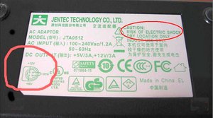

Hi, I got a dns-323 from a friend, but he lost the power supply. I got one from a Lacie disk that gives out both 12v & 5v but i´m unsure if the pinout will match! does the original power supply tell the pinout?
Sorry, I missed that! Your help was more then enough!
Christian Drake, I attached an image that will show you the power brick and the corresponding pinout. This should answer your question. there are some great sites out there to modify your DND-323 and do not forget it's twin, Conceptronic CH3SNAS. Anyhow, check the links and you get to learn a lot about it...:-)

The originally attached picture
It has the diagram of the plug on the Jentec JTA0512 AC adapter label.

The originally attached picture which is no longer visible can be found at https://web.archive.org/web/201910302314...
It has the diagram of the plug on the Jentec JTA0512 AC adapter label. The plug looks like Kycon KPPX-4P or similar. With the plug turned so that the square keyed side with the two wider apart pins is pointing to the left, the top left is +12V, the bottom left is +5V and both the right side pins are RTN

Be sure that the replacement adapter has 3A (not 2A) as you will burn out the 2A most probably and lucky if you are at home and awake that moment.
I accidentally ended up purchasing a 2A PSU off ebay, so did some more investigation. This page suggests it should meet the requirements of the unit sufficiently though (assuming you do in fact get a full 2A for both voltage outputs?):
