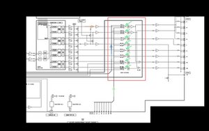

Looking at the audio block diagram on p.32 of the service manual for your receiver, one common factor for no audio out from any digital or analogue audio inputs, is if it is setup to receive audio from EXT in
Here’s an image taken from the service manual that shows what I mean.
(click on image to enlarge for better viewing)
The orange arrow indicates audio received from digital sources e.g. HDMI
The blue arrow indicates audio received from analogue sources e.g. AM/FM tuner
The green arrow indicates audio from EXT in (external source?).
Since you are not getting any audio out from any digital or analogue audio input connection, it may be that the switch (Zone2 - SB assign?) shown by the multiple green arrows in the red box is set to ext and not to either ana or dsp.

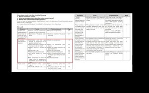

Here’s a image taken from the troubleshooting section of the user manual that shows what to check if there is no sound from the speakers just to help eliminate other possible causes.
Thank you! Zone setting didn't seem to have any effect, which isn't too surprising since switching to Headphone output doesn't produce sound. I tested using optical in, HDMI in, as well as tuner. I tried both zone settings, speaker sets A and B or both, too. Volume is not set to mute and I don't even get a static hiss when I turn the volume to maximum. Also, I don't hear the usual pop sound when plugging in the headphones.
However, I already found a bad relay along the path you highlighted (I have a copy of the service manual, so I was able to compare the block diagram to the circuit schematics). I now have a breadcrumb to follow :)
