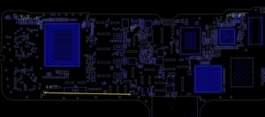

I forgot to press the battery disconnect button prior to swapping the trackpad cable in a 2016 A1534. I noticed a little spark/sizzle/smoke come from the logic board sizzle as I was closing up the Macbook. Needless to say the keyboard and trackpad are no longer working. I took a close look at the logic board under a microscope and I found nothing but a nice big solder ball sitting between the pads of L4803 .
I’m not too familiar with board level repair but I’ve been reading a bit about it in light of this disaster and I figure since I have access to all of the tools required to attempt repairing it that I could give it a shot. I don’t see any traces leading to L4803, does anyone know where I would solder a jumper wire?

One line goes to the trackpad Zif connector and the other one can be soldered to a few components following the inductor
L4804 & L4802 also blew up
L4804 lost both pads - there's a tiny bit of solder still connected in one of the pads
L4802 had one pad that was lifted- I used some conductive wire glue to secure it back onto the board and have replaced it. I'll add a few more pictures.
@berniemacbook
connect one jumper from pin 1 of L4803 to pin 1 of C7670
Connect another jumper from pin 2 of L4803 to pin 14 of the trackpad connector

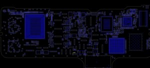

You could do that with L4804. If you need to run jumpers connect pin 1 of L4804 to pin 1 of L4010
connect pin 2 to pin 24 of the connector
Thank you very much. As for L4804, would I just follow the trace to the trackpad zif connector pin, solder a wire to it, and then scrub away some solder mask on the opposite side and also solder a wire to it?
@oldturkey03, thanks again for your help.
The best I could manage were screen shots from a board view file. You might need to jumper over to the nearest remote points.

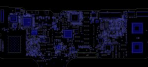

It might be easier to give you the resources, in case you need to trace more.
I found the board view and schematic here:
https://www.ghostlyhaks.com/forum/macboo...
Software for the board view here:
https://openboardview.org/
Open the software, open the brd file in it, then Control + F and input L4803, press enter and it will highlight the component. The circles represent the pins, when clicked it shows lines to connection points.
@geekittogether what 820-xxxx number is your boardview from?
It was 820-00045
My board is the 820-00244, sorry I should have mentioned it in the original post. I was wondering why the layout appeared differently. Any idea where I jumper on this board?
