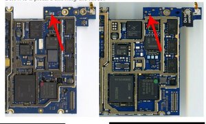

karim, since you have replaced the battery and the dock connector and hoping you did a flawless job on it, check the fuses and see what you get. The "slide button" could be totally different issue. Possibly need to reset the flex cable and/or a new digitizer. Just as an update, I posted another one of my pic's for fuse location left is 3G right is 3GS. Dimensions are 3GS fuse is 2mm x 1.20mm and the 3G one is 1mm x 0.30mm approximately. This information is from my notepad and not sure where I got it from, but I do believe it is from one of the forums. So I would like to give credit to the anonymous author ;-) Based on these specs the appropriate part number (Littelfuse Inc) seems to be 0435002 for 3G and 0467002 for 3GS. A small note about 3GS: the above fuse size is 0603, a little smaller of the original. The correct size is 0805 (2012 Metric), but unfortunately Littelfuse doesn't have this size available. An alternative could be MFU08052 from Vishay/Beyschlag Inc. Good Luck

where is the fuses located please? you have pictures?

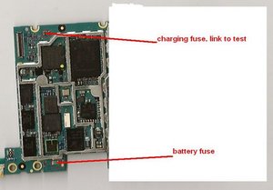

karim, the picture of the fuse location is attached to the original answer ;-) You test the fuses for continuity with a multimeter. http://www.electronicrepairguide.com/how... explains that a bit better and it has pictures. The only difference here is that your board has SMT fuses but same principal. Good Luck

That picture is for the 3G, cause my board is different, it is the 3GS, i can see the battery fuse and i tested and it is OK, shows continuity.
Let me try and find the charging fuse, if you have a picture of the 3GS board that would be great
Thanks very much
Hi oldturkey
i have tested the battery fuse and also the other 2 at the bottom, and they are all good, all show continuity
so i think the problem is not the fuse, not the battery,, not the charging dock!
