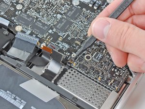

You talk about the battery checker cable being frayed are you sure that’s the cable? Here’s the checker ribbon connection
