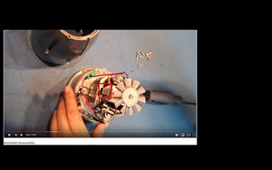

I’ve attached images taken from the video which show the motor brush holders.
At 2.03 minutes into the video you can see the brush holder with the black wire attached to it. (to the left of the fan).
(click on image to enlarge for better viewing)

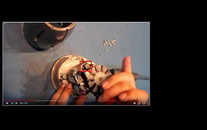

At 2:08 minutes into the video you can see the other brush holder on the other side of the motor, with the blue wire connected to it.
