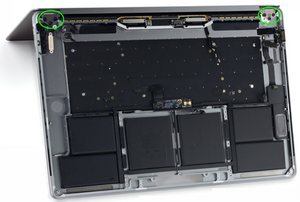

Hopefully the hinge screws are loose otherwise you’ll need a new display. Carefully pop off the bottom cover, then remover two plastic covers over the hinges:

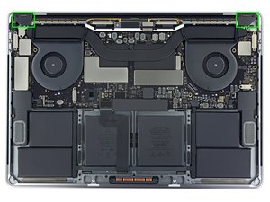

Then you’ll need to check these screws:
@leandermode - the hinge design in this series is very different from the older models. This series uses a press-fit pin into the upper lid case. The pin is keyed so its not free spinning and the clutch spring bites into it
The only correction is replacing the full display lid assembly.

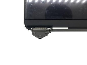

Any idea if it's possible to remove the press-fit pin mechanism and transfer it to another assembly? My replacement part came without a hinge.
@sardar.lopez - What???
Clearly you got the wrong part as every one I've ordered have had the hinge pin and the hinge pieces as show in the pictures I've posted.
Here's the correct part: MacBook Pro 15" Retina (Late 2016-2017) Display Assembly At you can see in the iFixit parts picture the hinge is present on theirs.
I would love to know where you found this part and some pics as well.
I've got mine used from Amazon. It's the correct screen minus the hinge on the left. It's less than half the price so it would be worth the effort if it could put my paper weight of a MacBook Pro to use. Thanks for the reply.
