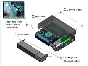

Why does the open/close button not work
I have disconnected both the audio and HDMI cable from my device.
After turning on the device, pressing the open/close button has not effect. The green power led is on.
I have tried resetting by holding on the open/close button, and the plugging in the power cord. This did not fix the problem.
Any suggestions or advice would be gratefully received.
@igreid wonder if it is in demo mode. While the player is turned on, press  ■ (stop) , RETURN, (pause), and then the SUBTITLE  button on the remote to disable it.
You can also try to open the case by inserting a paperclip in the hole of the drive
Thanks for the suggestion. This did not help.
This is the second unit I have had this issue with
Not sure what to do next.
