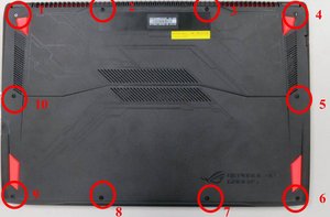

What size is the screw by right hinge?
The screw near the right hinge by the power button, in the bottom of the case backed out. Due to this, excessive stress is being placed on the hinge. i need a replacement screw. What is the thread size?
All 10 screws on Bottom Case are of the same size: M2.5*12L
