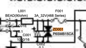

Hi, I know this post is from a very long time ago but I have just fixed a Sony ps-lx310bt with no power and managed to find a fault that may be common to these players.
Upon opening the bottom of the player I started looking for voltage going through the main board, which wasn't present anywhere. After working around the board I traced a short circuit to a Zener Diode on the board labelled ZD001. After identifying the component and sourcing a replacement, resoldering the new diode on to the board fixed the power issue and the player booted back to life!
Hope this may help people in future in case this is a common fault.
Hi @nathandawson , i've had exactly the same problem as you. I accidentally plugged in a 19V/4.7A power supply into my Sony ps-lx310bt and since then no power anywhere.
Couldn't find any power on the board using a multimeter, so I tried unsoldering the Zener Diode ZD001 from the board and hey presto the bluetooth light comes on. I havn't tried anything else until i've sourced a replacement.
I'm wondering if you could help me identify the replacement zener diode? Do you happen to remember which one and where you bought it from? I really don't know what i'm looking for. Tried to google the number written on the diode but can't find any references.

Hi, I forgot about this post a while back! I have the details of the zener diode I replaced it with, and this data was found with the help of Littelfuse themselves.
The replacement I used is a Littelfuse P6SMB15CA.

@roberthardwick I think I have just found it actually P6SMB15CA, found here https://www.manualslib.com/manual/298375...
Technically, that is a TVS = Transient Voltage Suppressor, its purpose is to suppress transients caused by lightning and other phenomenon. Per its datasheet, "• Typical failure mode due to exceeding maximum ratings is a short circuit condition". Breakdown voltage is 14.30 - 15.80. 19V qualifies as "exceeding maximum ratings".

2025 still helping! Above is the answer. Remove the TVS everything works
August 2025: I did the same thing and accidentally plugged a 19V cable into it. It wouldn’t turn on.
Removed the ZD001 diode and it works again! :)
that diode did what it was suppose to do. It was guarding against you plugging in the wrong thing. I would strongly advise that your replace it - instead of just removing it.
@billruggir58356 Hi! Absolutely. Ive already ordered a new P6SMB15CA diode :)
