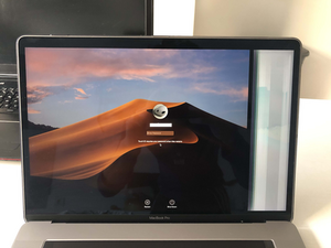

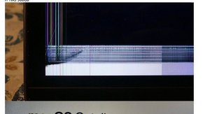

Basically today I was using my macbook pro and the screen suddenly started flickering green and pink horizontal lines and sometimes it shows a big vertical line when open or close the lid and also the vertical lines appear in different background, I take good care of my tech so i didn't hit or drop my macbook pro, I'm a full time student and my Macbook Pro warranty expired like 15 days ago, I don't have money to repair it and there is no Apple Store in the country that i am right now so I can’t get it diagnosed officially by Apple.
In this picture you will find some of the horizontal lines
In this picture you will find the big vertical stripe that appears when i open or close the lid
In this one it shows more of the lines like the ones of the first picture but this appear on black background which it is very weird
And in this video you are going to notice some random green and pink dots that flashes very fast in the same place of the big vertical stripe.
Note: I already reset PRAM and SMC, and started safe mode with no luck. I connected the macbook pro to an external display and it works great so GPU is good.
Please help me, thanks in advance.
UPDATE: So the stripe is not appearing anymore but the horizontal lines still appear in certain backgrounds it really depend on the colors that are being shown in the screen being black and white the ones that provoke the lines most.

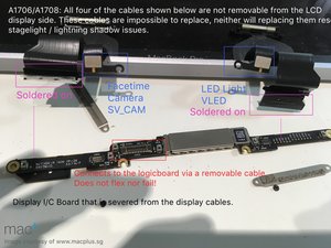

The link Kevin posted aimed you to had to do with the backlight having issues. In your case there is a different set of cables which carry the video signal. But I don’t think thats your issue ;-{
Here you have two different issues the first are the artifacts on the screen. This is caused by stale information still held in the VRAM buffer which corrupts the screen image with the horizontal lines and blurs. The second is the more troubling one as the vertical bar is a display failure! This often happens when the lid received a bang or crushed so the fragile connections to the LCD panel gets damaged. This is where the flexible cables are bonded to the glass LCD panel often called a TAB error. Basically, the bonding had broken free sometimes there is enough tension to hold the connection together so it will sometimes work and then not.
Here’s a deeper view of your screens connections between the display assembly and the T-CON board. It’s possible the video signal cables could be damaged as well. I haven’t seen the vertical bar condition in this series yet. Unlike the older models the T-CON board was within the lid its self here it’s been moved to the main case location.
Now the bad news somehow you need to get your system to Apple ASAP as Apple might repair it under warranty as you are so close to the cutoff point. You will likely need to do some groveling and if that fails push the issue up the food chain to get someone to cave-in. If that fails OUCH! As you are looking at least a new display assembly and maybe a new logic board as well each is about $700 USD.

This is not the FlexGate issue whee you see the stage light effect. This is a failing T-CON board which is part of the display assembly.
The needed correction is replacing the display assembly!
