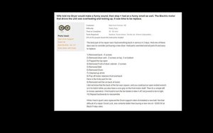

It may also be that the drum roller bearings or drum roller axles are worn.
I couldn’t find a free service manual online but I did find a video on how to replace the rollers and this account of how to access the motor (and also the rollers?) which may be of some help.
(click on image to enlarge)
Hopefully this is of some help.
Most Kenmore dryers have a belt around the drum with the motor driving that belt. It's been a long time since I opened one up, so I can't remember details but I believe the drum rotates on guides. I don't think there is a shaft in the rear. Those might be where the problem is.
