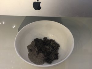

Also, have you vacuumed the vents at the bottom? If not, do it NOW! Check my photo on the threat to see just how much you could get out. All that dust was definitely preventing my fans from doing their job properly - my machine is soo much happier now :]

I finally found SOLUTION and the real reason behind the heating…. DUST!!..
I was ready to send it for a real diagnostic / repair an decided to clean it from the outside a little. Took my vacuum cleaner and taped the bottom with plastic and duct tape as to only allow the vacuum to clean the small air intakes for the fan. Nothing came at least not much. Went to the store and bought pair of air dusters and used all of it in the same place, directly into the small openings with the air duster tube….. clumps of dust came rushing and after the cans ran out of air I used the vacuum to clean once more and this time a lot of fine particles of dust were visible.
Booted the Mac and the first thing I noticed was the GPU Diode running at 39ºc while idle, instead of 60ºc and running CINEBENCH never made it run hotter than 80ºC.
I always clean my Mac, with Air Dusters, even the air openings but never the whole can with the tube sealed directly into the aluminum.

DUST WILL DO THIS ALL THE TIME! It is a known fact! Get an iFixit kit and take the iMac apart - it is not that hard! There is an insane amount of dust in ANY iMac that is over 3 years old! THEY SUCK in so much dust my GPU Diode was 228F! INSANE! Black screen happened often with heavy Photoshop and certainly with Final Cut. Now? All is well. Takes about 2 hours and I put a new 2TB SSD in as well! Best thing to happen!
This is how much dust came out of my 2014 5K today. D:
I’m now running about 20 degrees cooler than I used to be!
