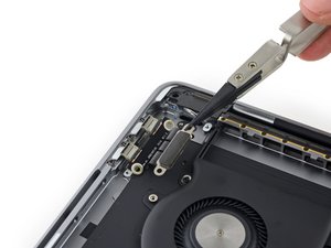

The 2018 teardown does gloss over some of the details as Apple is basing the updated system on the older 2016 model. So if you look at the 2016 teardown you’ll see the USB-C port assembly is removable!
And heres a better view of the connector assembly being removed from the case
So, yes you can replace either one as needed. But there is still a wrinkle here!

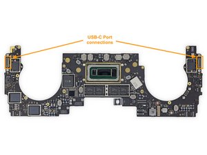

What if the connector is not the issue but the logic on the logic board which would require a new logic board. While not obvious each pair of ports has its own Intel JHL6540 Thunderbolt 3 controller.

Does the controller to each usb-c port live on that removable pair of ports or on the logic board itself? Thanks
No, the logic is on the main logic board, the connect is all thats on the removable part.
