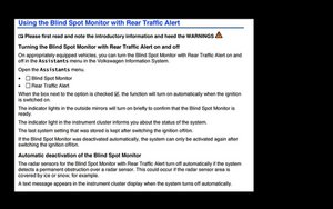

Is the Blind Spot Monitor function light coming on in the dashboard instrument cluster, when you first turn on the ignition key?
Here’s a close up of what it looks like (picture of a car in an exterior car mirror)
If this light is not showing when you first turn on the ignition you need to activate the Blind Spot Monitor system.
