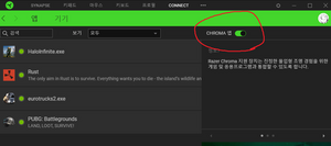

recently my RAZER Macro keys of Blackwidow (M1~M5 keys) input speed slow down.
(kind window slow problem - they input funtion of M1~M5keys and there are deep delays - keep Ctrl hold kind...)
but i got a hint from these answers.
so i just turn off and back on about CHROMA color fucntion. it's fine now.
thank you guys.
