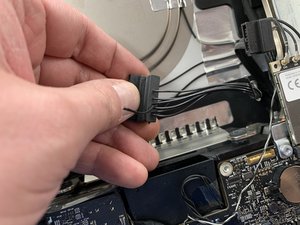

The SATA data connectors are very standard and so is the SATA power cable feeding the hard drive. The only difference is that they used 7 wires instead of 5, probably some extra grounds.
I installed a Vertex3 SSD and used a plain 4 wire Y-splitter sata power cable which effectively discards the 3.3V from the apple's wiring and only feeds 5V and 12V to the original drive. Guess what, fan speed is as quiet as it can get and the Apple Hardware Test passes successfully.
I went further and moved the internal HDD from SATA0 to SATA1 port to better accommodate the SATA connector for the SSD and this didn't create any adverse effects.

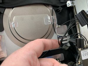

I couldn't figure out how to route the cables, but then I loosened the GPU screws (T8 and one T10) and pushed the original SATA cable underneath, which did it nicely
Thanks Hanno for this hint!

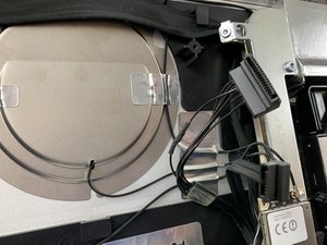

It should be noted here that on the SATA side of the cable the wires 1 and 4 have to be shorted (and NOT wire 2 and 7). This is much easier then Apple's official solution where you have to take the iMac almost completely apart.
For better understanding I have added below some (low resolution) photos. (Sorry for the bad quality).
CAUTION!!! This modification is ONLY VALID when you switch to a solid-state drive (SSD).
DO NOT use this mod to connect a normal harddisk drive! This will most likely result in massive overheat of your iMac.
