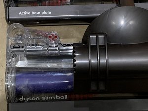

The suction is so strong that on thicker carpet it is almost impossible to push the vac through the carpet. Just started doing this recently, washed the filters and still have the problem.
Any type carpet the only thing I use it for is hard wood and concrete floors and hose accessories. The other model dv7 has suction control that allows carpet vacuuming. Otherwise look else where to spend your money .

For the Dyson at least, you can remove the sole plate from the base (just use a nickle or something, turn the 2 or 3 sloted “keys”, and pop the plate off). Around the edge, you will see a black foam rubber strip. That strip is an unnecessary item, and you can just pull it out. Replace the sole plate. Now, the suction (and moving air) can get out a little around the sides, makes it stick to the floor a little less.
As to why the suction has increased from what it once was, I don’t know. Perhaps the motors gain RPMs with age as they wear down, but that’s just a small guess.

That was the perfect fix. The way I removed the side gasket was to remove the adjuster plate and then take some small scissors and cut the rubber gasket out of the sides only. The vacuum still has plenty of suction power and you can actually use it now on dense low plush carpets without breaking a sweat.

Seems lots of lots of fixes. Here is mine i just tried. Works well with no damage to the vacuums head. The zip ties restrict the vacuums seal to drop all the way. Reducing vacuum and allowing a much easier push/pull. See the pic and remove the bottom seal and add 2 ties per the photo. Put it together and try. This is my first attempt and larger ties could also be used. I hope this helps.

Ours is an Animal 2 so it is slightly different - but you just find the piece doing the same job of allowing the "self-adjusting" head to float and stop it. You might experiment w/the size of ziptie for best results.

I too had this issue (my wife said return it) and I resolved it by using ty-straps at opposite corners. This way I wasn’t interfering with the wheels and I wasn’t physically damaging the head unit. I called support and they sent me a new head (see pic) this one works fine. I am guessing the perpendicular open slits on each end is the reason. It is a smaller head width\depth wise, so I guess if you are still under warranty call and complain and maybe they will send you a new head.

Just acquired a DC 42 same problems,so I took a gamble on drilling 4x 4.5mm holes on the side of the brush bar head, 2 on each side,and this has resolved the problem. Shame Dyson didn't put an adjustable vent on the sides. Cheep free fix. Now vacuum up without putting my back out.

I didn’t see a black strip to remove on mine, it was a full rubber gasket that I did not want to cut off. So, found another solution!
If you don’t want to cut the gasket, use high quality flat rubber bands and wrap them around the very edges of the sole plate to push the hanging rubber gasket back up. I used these flat beer charm bands we had leftover from our wedding - you can buy here https://amzn.to/3DBTCrm Make sure you put it on the very edges of the sole plate before you hit the rotating round brush tube on the inside! And keep the rubber circle on the upper edge so it doesn’t drag on the floor and cause friction. A large flat rubber band would also probably work but you might have to replace it every few months if they snap easily.

I did not want to permanently modify so I tried the wire tie suggestion by williams and Barry Armitage.
Fist pic shows the wire tie on the back posts and on the bottom right you can see the red locking lever in the unlocked position. Just opposite on the left you can see the socket where the locking pin goes in.
The next photo shows the pin partially inserted to where I met resistance.
The next shows my forefinger and thumb squeezing together to seat the pin all the way. Very important because if you use the red lever to try and lock it you risk breaking the plastic piece.  It should be every easy to rotate the locking lever.
Final photo show the pin all the way in and the lever rotated to the locked position.
House keeper is now happy with vacuuming all 3 rooms w/ deep pile carpets.
